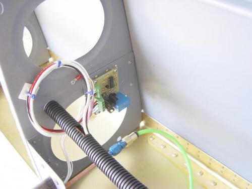

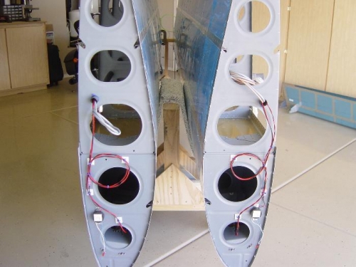

Finished most of the wiring for the wings. All wires have been run through the conduit. All connectors on the wing tip end of the wires have been installed. (LED Nav, Strobes, Landing lights connected and tested. D-sub cable made and connectors installed both ends for roll servo. connector attached to roll servo and locktite and lock washers. Heated Pitot installed and tested and plumbed to pitot line . RG 400 Coax run for Nav antenna in Left wing. I'm going to wait on the inboard connectors until final wiring, I may be able to eliminate some connections.
LED powerpucks riveted.Duckworks landing lites connected, strobes ready w.mate n lock, Nav coax run
Gretz heated pitot connected, tested and plumbed
