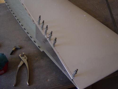

Brief Description:  Sec 24-3 steps 5-7 left
Finished the Left wing tip, resquooze the dimples after filing down the dimple die, also used dremel to even the height of the dimples, which I believe was contributing to the puckering/bulging. Installed the tip rib and riveted it. I got some bondo to clean everything up. I'll wait until the Right tip is done and then bondo both.
Clecoing tip rib
Clecoing tip rib
Bucked all but the last where I used some pop's
