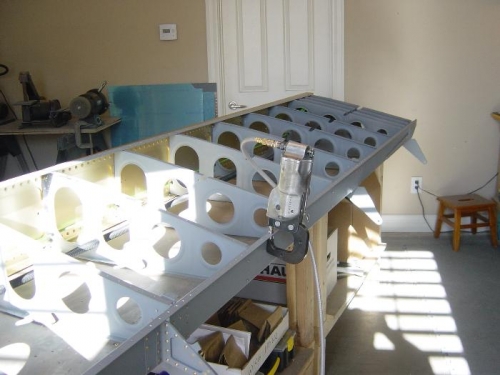

Dissassembled the Left wing, deburred all holes and edges in skins and ribs, scarfed joint between inboard and outboard wing skins, dimpled wing skins and ribs and top of rear spar and j channel. Scotchbrite and primed all parts. Reassemble and cleco both skins, wing walk doublers, and J channel stiffeners. Loaded and taped rivets for inboard top skin.I'll be glad to get to the end of the wings, They are BORING! I knew this when I started on them, Theres many of th esame parts Ribs & Skins, and you have to make 2 of everything. i look forward to getting started on the Fuse, as it seems a little more interesting (and it's another step closer to finishing!)
dimpling wing skin joint
dimpling Ribs and Top of rear Spar
