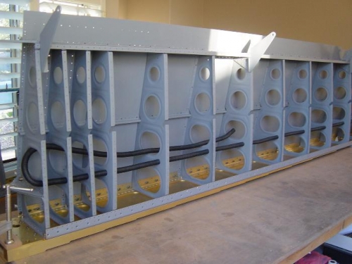

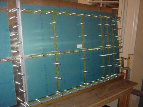

Dimpled ribs and rear spar, deburred ribs and rear spar, clecoed W1027A&B,W1002 &W1003 to ribs and spars, loaded and taped all AN426 3-3.5 rivets for riveting tomorrow.Ordered Roll servo, Gretz heated Pitot and Bob Archer Nav antenna from Stein today.
Everything primed and ready
Cleco skins to ribs and spars
