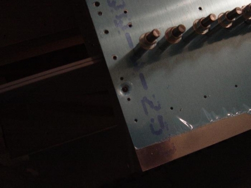

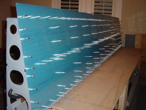

Proceeding with Right wing while waiting for Van's to ship replacement for defective Left rear spar. Clecoed the wing walk doublers, the inboard skin and the outboard skin, to the ribs, front and rear spars and the "J" channel stiffeners. Match drilled all #40 holes, Countersunk the holes common to the wing walk doublers. Tomorrow, DDD (dissassemble, deburrrrrr, dimple)
Clecoed and match drilled
Dimple this single hole for #8 screw
Countersink all #40 holes common to the wing walk doublers
