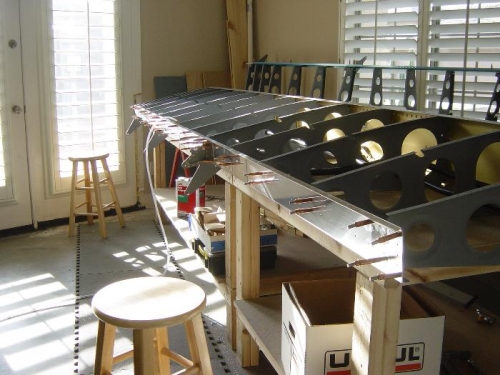

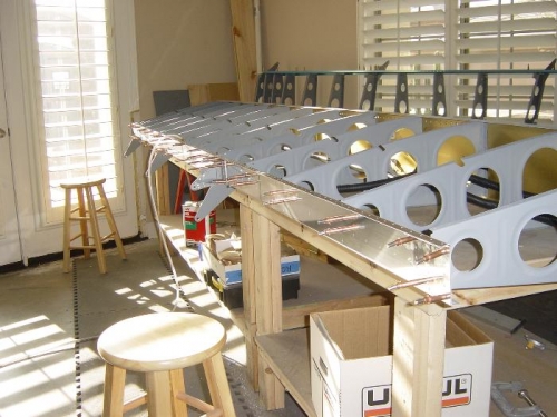

Prepared the right spar doublers and match drilled spar and doublers to Wing ribs, disassembled everything, and deburred edges, and all drilled holes, tomorrow, scotchbrite and prime and rivet
Right spar clecoed to wing ribs
Match drilled all common holes
