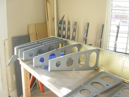

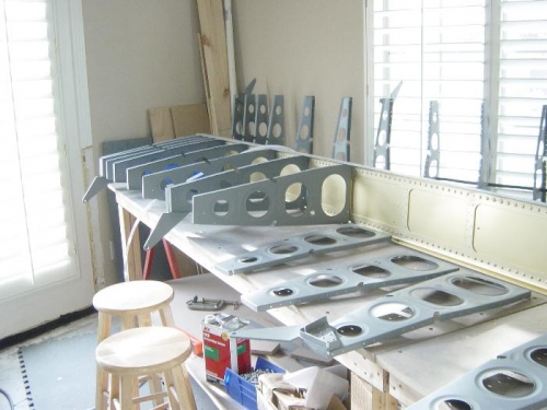

Riveted Flap hinges to wing ribs, Riveted belcrank assembly to inboard rib, Riveted all Right wing ribs to main spar, installed AN3 bolts of various sizes and torqued 20-25 in lbs. Riveted forwardmost rib of 7 inboard ribs in right wing. Installed Vans 3/4" conduit
Oops! Riveted this one in upside down?
That's better!!!!
That's better!!!!

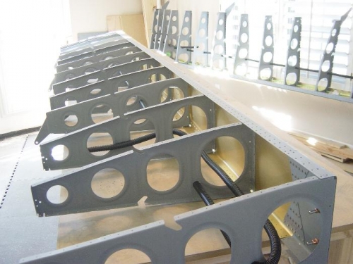

All Wings ribs installed Both spars!
