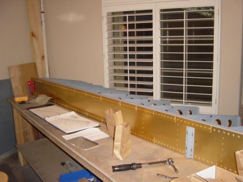

Installed all of the AN3 bolts of various lengths and torqued them to 25 in lbs. these wings are LARGE!
Left Wing Ribs Attached (iveted&bolted)
AN 3 bolts various lengths installed and Torqued 20-25 in lbs
