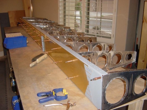

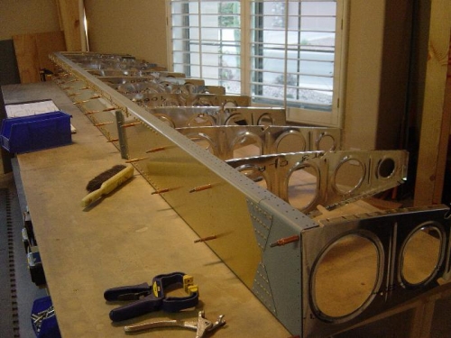

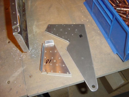

Clecoed the Left Wing ribs to spar, cut out the portions of the ribs noted in steps 1 &2, and match drilled all #12,#30 & #40 holes common to Spar and ribs. Deburred 2 o3 3 Flap hinge assemblies.
Left wing ribs clecoed and drilled
w/ Flash
Deburred the Flap hinge assemblies
