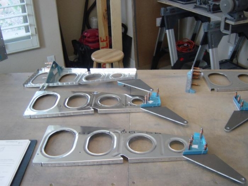

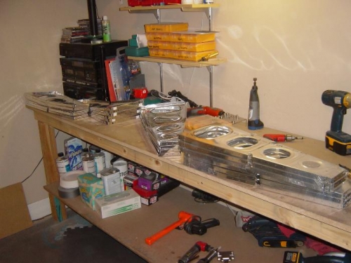

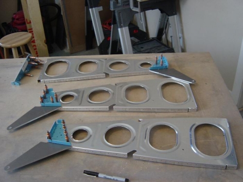

Prepaired the wing ribs for attachment to main spar. I only have enough room in the shop to work on one wing at a time, however I'm fluting/straightening, deburring all of the ribs at the same time so that once the Left is done, the Right should be straight forward. I cut the 3/4 x 3/4 alum angle too short for the Right wing, and had to order some from Van's , bummer the part is only $3 but who knows how long it will take for them to process and ship it, oh well, there's plenty to do, the right wing may have to wait a bit. Got all of the ribs attached to the Left wing and match drilled all holes. Also deburred 2 of the 3 flap hinge bracket assemblies. Tomorrow, I'll dissassemble, and prime the Left ribs for riveting.
Right Wing Flap hingea
Left Wing Flap Hinges
All ribs fluted and straightened
