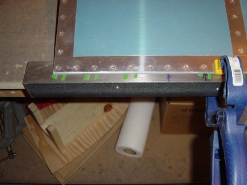

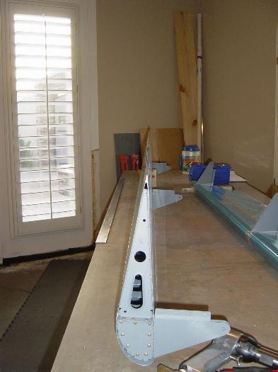

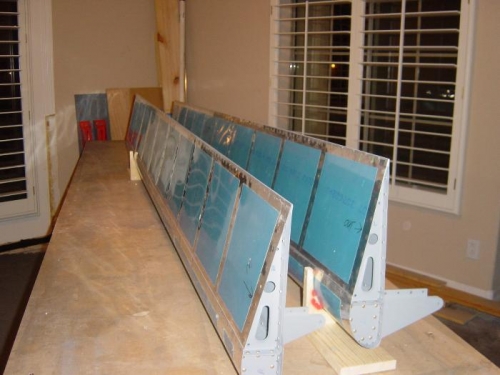

Finished riveting Flaps. I'll wait on the hardware install until attaching to wings. I used the angle iron back riveting technique once again, on;y this time I did not alternate rivet heads as I could n't figure out how to back rivet with the hinges sticking out so all machine heads are on the same side (top). Turned out nice and straight! Again no Pro-Seal.
Left flap complete
Left flap complete
Back riveting trailing edge,
Both Flaps complete!!!!
