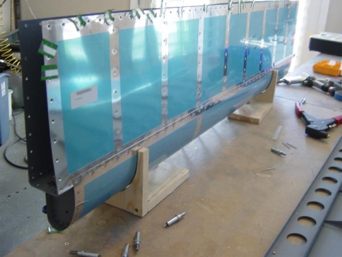

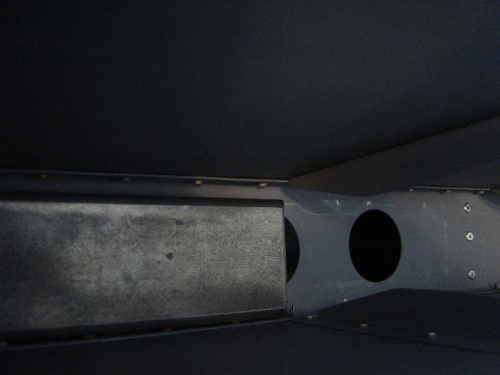

Riveted top and bottom skins to both D cells & spars (L&R). TIP, I had some difficulty finding a bucking bar that would fit between the skins when doing the bottom skin with th top alreadyt attached, I found that the special purpose bucking bar that you use for the HS fits perfectly between the spar flanges, and you lay it flat, put some pressure with a finger against it to snug it up to the rivet head, and it works fantastic, just start at one end and keep scooting it along as you go.
Secret weapon bucking bar!
Left skins attached
Left skins attached
Another shot of the Secret weapon!
