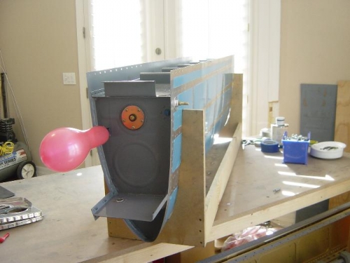

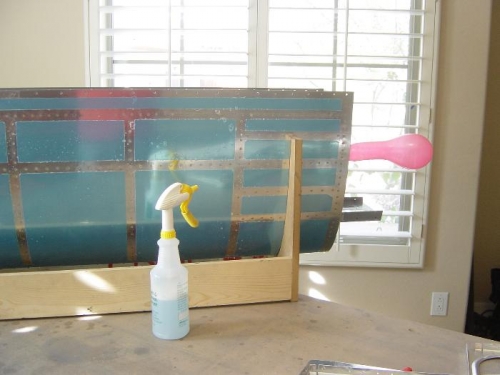

Brief Description:  Sec 18-8 leak test #2 (and repair)

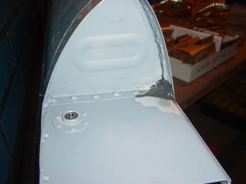

re-ran the leak test, the right tank is just fine BUT, unfortunbately there is still a leak in the left tank. This is th eone that i believed only had 1 leak, but after that one was patched it revealed its 'companion' similar to the right tank, I'm miffed that there is yet another leak, but at least it's in the same location a the others, I went back through the photos that I took at that time, and I just plane old missed putting globs of proseal in these corners, The plans warn you about doing so when installing the baffel, but not here, oh well, they are now patched and I'll test them Monday and hopefully they will show the same results as the Right tank (No Further Leaks)!
Right Tank test fine after repair
Ditto
Ditto
The 'New' leak is on the otherside of the patch
