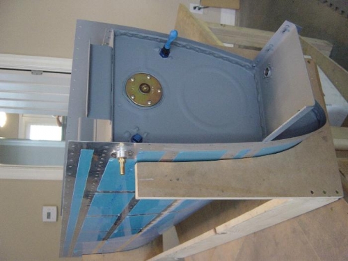

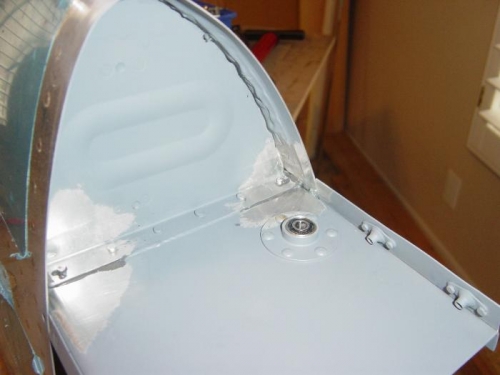

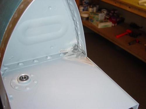

I decided that 3-4 weeks of cure time was plenty and figured today was a good time to do the leak test on my tanks, prior to moving them to another storage area. After all of the extra Pro-seal that I used I really wasn't expecting to find any HOWEVER, much to my chagrin, they leaked Big Time! Both tanks had large leaks in exactly the same place.s I don't know how I could have missed getting these ealed, but it's now apparent that i didn't. the attached pics show the location. Th egood news is that it ;looks like it will be easy to fix from the outside, I've cleaned out the affected area, took th ePro-Seal out of the freezer to thaw overnight and tomorrow, i'll apply some major 'Globs' to the affected corners and then let then cure for another week, and then retest
Everything set up for test
This one only leaked in one of the corners
This one leaked in both corners
