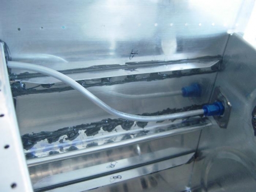

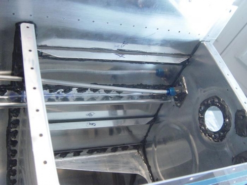

Well, I really blew it on this one, I Threaded the Vent tube through the UPPER hole in the rib series, there wasn't enough lenght @ 63" to attach to the fitting and to the vent clip, so I bought more and cut the line a couple of inchesw longer. I posted this to the Matronics RV!) list, and instantly got back a suggestion that I had routed the line improperly, and that the line should be routed through the 2nd lower set of holes. I quickly went back out to the shop, and undid the install, and rerouted the lines per the corrected instructions. It's not clear in the plans and the picture doesn't cleaqrly show you. So for all of those that come later, make sure that you route the line and the snap bussings through the lower set of holes, the ones that are closer to the J channel stiffener. When you do it right 63" works out perfectly!!!!!
Correct routing
Correct routing
