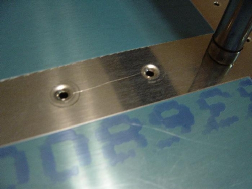

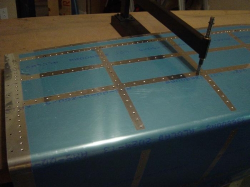

Dissassemble, deburr, the RIGHT tank. The Tank Dimple die from Cleveland arrived this afternoon. Dimpled the LEFT skin.
Dimpling LEFT Tank Skin
New Dies make slightly larger/deeper dimple to allow for Pro seal to seal the rivet
Shows AN426-3 sitting slightly lower
