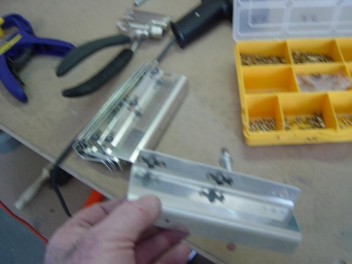

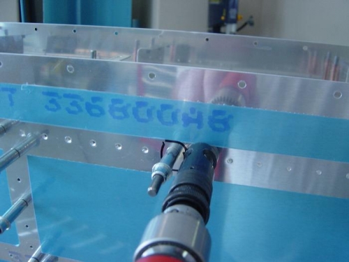

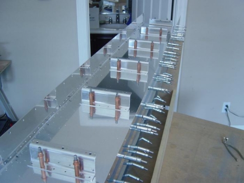

install nutplates on zee blocks, install inboard aft rib, cleco and drill, install aft rib baffel and cleco zee's and ribs, Match drill, all remaining holes, countersink the skin to baffle holes. Left tank ready for dissassembly, I'm going to set this aside and get the Right tank to the same place. So that when I start the ProSeal, I can move through both tanks, one after the other, and get that out of the way.
Attach nutplates to the Zee's
Zee's and aft baffle installed and match drilled
Countersink skin to baffle holes, kleaving every 10th hole uncountersunk
