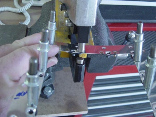

Finish the Stall Warning work for the Leading edge completion. Dimple the doubler, skin, and cover, attach nutplates, rivet doubler to skin, and nutplates to rib.
Attach nutplates to doubler

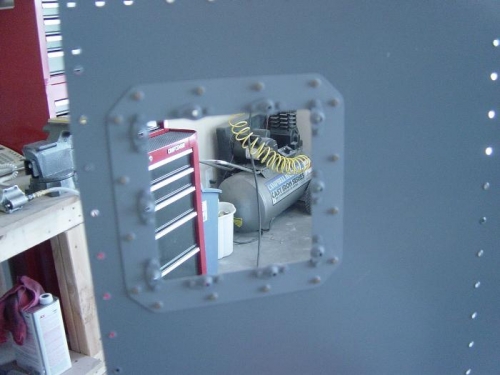

doubler riveted to left leading edge skin

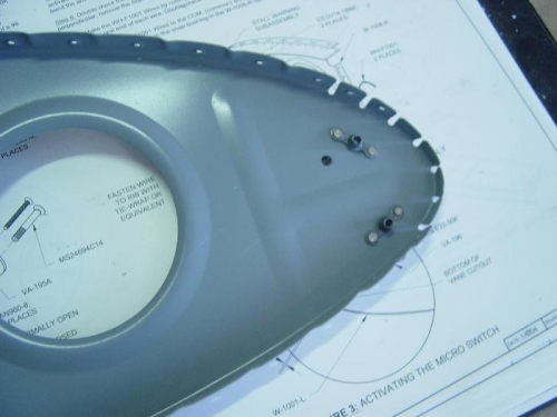

nutplates attached to Rib for stall warning attachment
