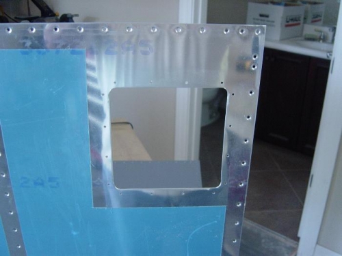

Cut access hole in Left LEading edge for Stall Warning access. Install doubler. It's easier to do this while working on the Leading edged while they are open and not riveted up.
Cut out the hole using doubler as a template
Deburr the doubler and cover
Deburr the attach rivet holes
