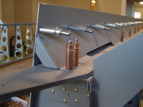

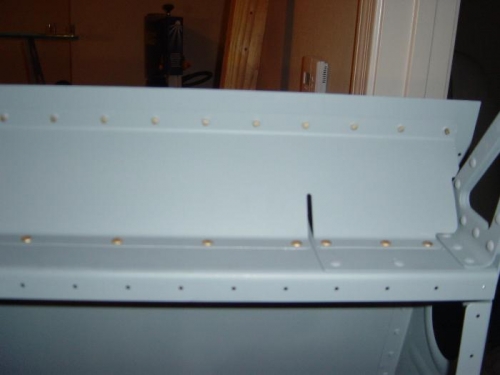

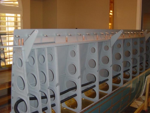

Installed Aileron and Flap Gap Fairings. Match drilled All #40  holes, then dissassemble, deburr holes on wings,spar, and fairings, deburr fairing edges, dimple for #40's the fairing and the Top wing skin, Scotchbrite, MEK wipe, and prime the Fairings, Re-Cleco in place and then rivet (#40's and #30's). This took longer than I expected, but Oh well!. waiting on Stein to ship the Roll servo, as it will get mounted into this wing, and the heated pitot into the left. Next step attach the Flap and aileron.
Primed and Ready!
Primed and Ready!
End Close out tab riveted
Close -up, outboard end aileron fairing
