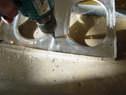

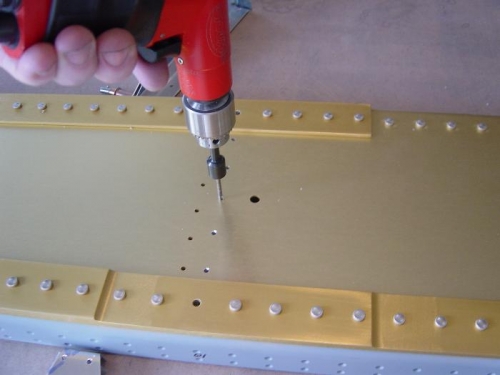

Straightened flanges on all Right wing ribs, Clecoed to spar, match drilled, enlarged hole w/ step drill to 3/4" for electrical conduit in all ribs, Drilled #12 Holes in All but last 3 ribs, dissassembled, and deburred all holes in spars and ribs, deburred the flap hinge assemblies and the inboard flap hinge and torque tube bracket assembly. next step Scotchbrite and prime.

Enlarging hole for electrical conduit
Deburring spar
Deburring spar
