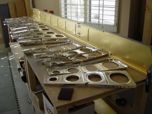

dissassembled,holes deburred ready for scotchbrite

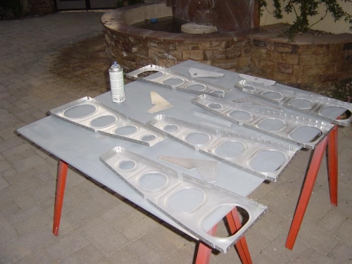

Prime w/ SW988 rattle cans

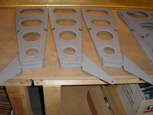

Flap hinge assemblies riveted an470 4-5
