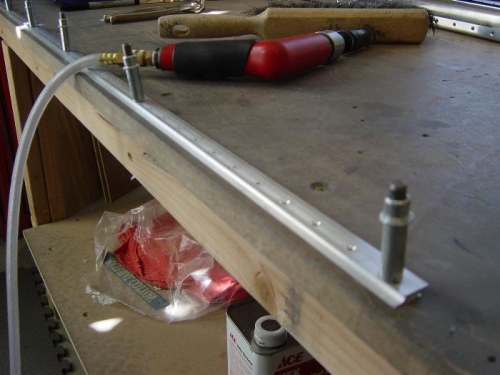

Finish dissassembling the Right Aileron, Deburr, Dimple, and Scotchbrite both L&R prior to Priming, Then primed both L&R parts. Countersunk the trailing edges. TIP - put one TE on top of the other and cleco them to the workbench, this makes the surface flat. Then countersink all holes on one side, flip it over, and contersink those. then seperate then and reverse sides and countersink both sides of the new bundle. Goes quick and eleminates the need for a jig.
Countersink trailing edges
