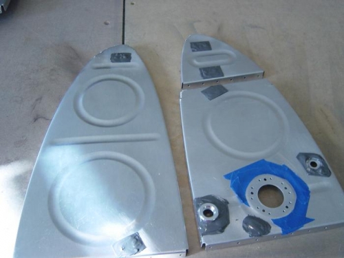

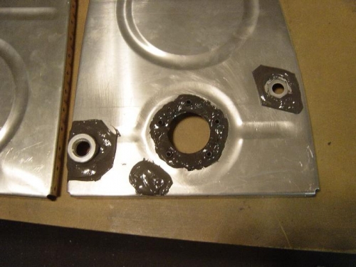

Closed off the tooling holes and prosealed the inboard and outboard ribs. I decided to put a couple of flush rivets into the punch die close out patches, used .025 scraps and an426 3-3 rivets. installed and prosealed nutplates for fuel sender. This stuf is a messy as everybody say's it is. In hind sight i probably used too much pro-seal, but I'd rather go a bit overboard and ensure I don't have any leaks now or in the future. I mkay have to order another quart, we'll see how it progresses. This took a lot longer than I had expected. May be beacuse of learning curve and constant clean-up. I had hoped to get this and the stiffeners done today, but the stiffeners will be tomorrows project, we'll see if we can geto both tanks done or only one.In the process of riveting the nutplatres, I clobbered a rivet in each tank, thought about drilling it out, but after cleaning everything up I decided it would do more damage and mess, and while it's not as pretty as possible, it's plenty strong enough to hold the sender.
masked everything prior
everything done except the nutplates
Nutplates done
Nutplates done
