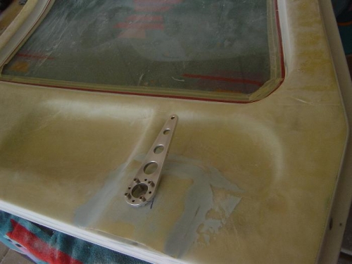

More finish work on the doors. Friday I primed both doors and sanded then flush. I also primed and sanded the perimeter of the pilot door. Today, I began with the upholstery panel for the pilot side, it needed reinforcement along both of the vertical portions, And I also needed to build a raised cover for the door latch mechanism, which projects slightly above the interior door surface. I covered the window and the posts portions of the door w/ Saran wrap, and then cut several 3" wide strips of 6 oz cloth and layed them up in stagged layups to stiffen the 'post' portion of the panels, where they were previously buckling when bent. I cut 2 5" sq pieced of foam, and bondoed them together, and then sanded them to a shape which blended into the esisting contour on the door panel. I layed the sanded foam blocks on the bench and taped them to the bench w/ duct tape and then did a 6 ply lay-up over them, cured them w/ halogen lights, removed the fiberglas piece from the 'mold' trimmed it to fit the door latch opening, and then clecoed it in place. Mixed some flox and attached it w/ the clecos. When cured I fille dit w/ some body filler and sanded it smooth. Reattached the dor handle w/ some larger screws and standoffs. I completely hided the hole and looks VERY good. I'll cover the panel w/ a very thin layer of foam rubber, and then glue the leather to that. It should look nice when complete. I then attached the door trim after allowing the primer to cure over the weekend.

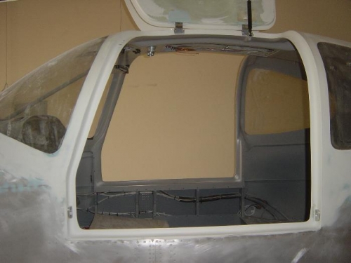

Re ground door frame primed and sanded
pilot upholstery panel reinforced and door latch mechanism covered

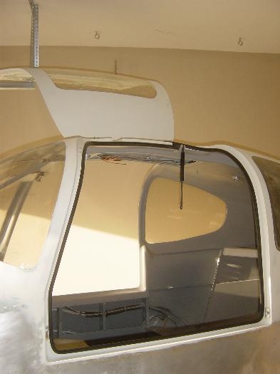

Door seal applied to pilot door
