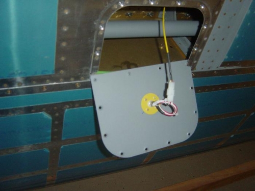

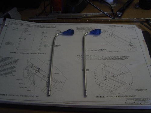

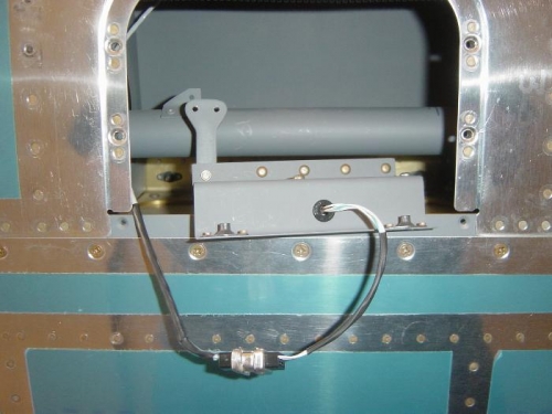

More finishing up of Sec 44. Fabricated the right and Left fuel vent lines. Also fabricated the fuel supply lines and fitted then to the lines which feed the Andair valve. (not pictured here). I still need to cut the end which attaches to the fuel tank to final length and install the AN fitting and flare, but that will wait until final assembly after paint. Next I'm trying to gett all of the fuse to wing connections sorted out so I can make the appropriate holes in the fuse sides for the wires/tubes to pass through. In the process of doing this, I installed the other half of the modified dsub for the RAC aileron trim servo, and also drilled and mounted the Shadin OAT sensor in the second wing access panel outboard from the fuse. spent some time ordering some connections and additional shielded strobe cable, which should arrive next week.
Fuel tank vents
Fuel tank vents
RAC aileron trim connection
Shadin OAT sensor installed
