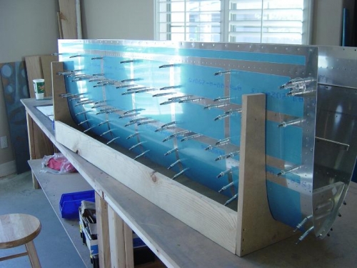

Clecoed the Stiffeners and the ribs to theLEFT skin. Match Drilled, the stiffeners, Match Drilled the Ribs, Inserted the J CHannel stiffener and Match Drilled, Cleco the Tank Attach Bracket and Match Drill.
Stiffeners and Ribs in place and Drilled

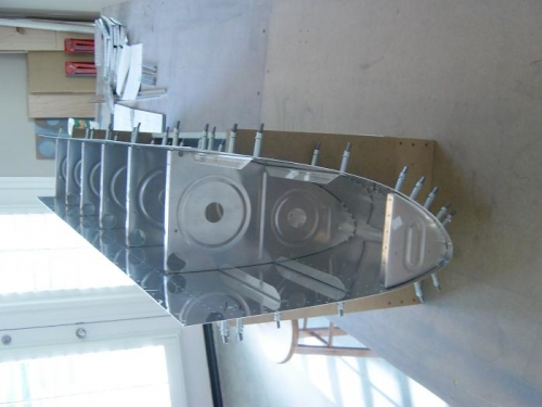

J Channel Match Drilled
Tank Attach Bracket Match Drilled
