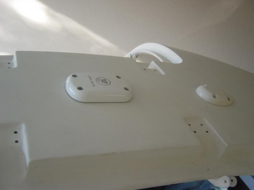

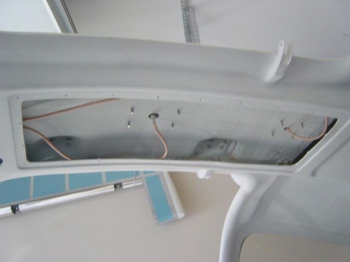

Mounted the WAAS GPS antenna, and the XM weather antenna on the top of the cabin. i had considered putting them under the cowl on the fwd side of the firewall, I don't think the fiberglass causes any significant signal loss, However, when I test fit the shelf I made with the antennas attached, it was clear that there is a possiblity of some blocking due to the upper firewall. So the Cabin top is ugly with the hinge openings already, So wha't s a couple of ugly antennas more? I attached the respective BNC & SMA fittings to the coax and secured the coax usuing snap bushings and tywraps. Plumbed as much of the pitot static system as I could. I'm short a couple of fittings. Ordered them from MSC they ship really quick out of NV. I also fabbed an engine ground strap from some braided material I picked up yesterday @ Aerozona. I soldered on some fittings, then just for grins I put a piece of 3/4" heat shrink over the length. I attached one end to the mounting bolt that holds the right magneto to the engine case, and the other got attached to the 'Forest of Tabs' on the engine side.
WAAS GPS antenna (fwd) XM weather (aft)
Coax & connectors attached
