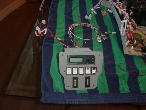

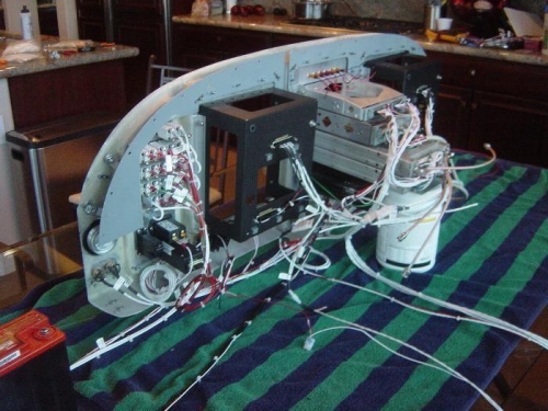

Cleaned up & labled all of the bundles. Began to wire the XM weather, Need to free up an RS 232 channel, Decided to sacrafice the COM2 (SL40) the only thing I will loose is the ability to tune COM2 from the EFIS, I used the existing wire/cable from the EFIS/MFD to the SL40, and disconneted it from the SL40 Dsub. Unfortunately the XM receiver requires a 37 Pin female Dsub! A trip to FRY's revealed they did not have any, so I came back and wandered thru Mouser.com and placed an order the the connector, and shell, as well as some TNC and SMA connecters required for the Antenna connections. I've ordered the antennas and they should arrive next week. I still need to do: 1. Attach Dsub connectors to trim indicators.
2. Wire the Master/Alt switches. 3. Make a harness for connecting the various devices to the rocker switches. 4. Make a harness for the annunciator lights. 5. Figure out how to secure the main cross harness to the panel for support. 6. Wire FreeFlight Dsub. 7 Wire XM Dsub
8 Bench Test
Center Console panel complete

Main instrument panel well on its wat

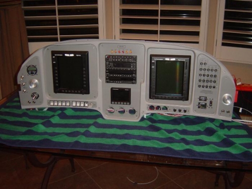

Almost ready for a power up.
