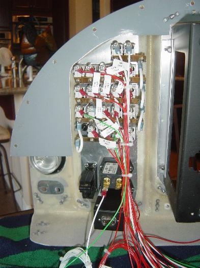

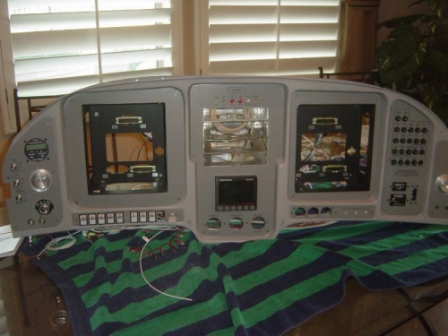

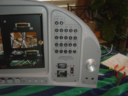

The kids have returned to school, but the heat persists. So I've capitulated and am moving indoors. I'm reassembling /testing the instrument panel and making some changes along the way. I reinstalled oll of the painted sub panels. and then mounted the EFIS mounting boxes to their respective panels. Installed the lighted rocker switches in their subpanel. I needed to update the Dynon D10A to the latest code (the one that supports HSI) Since the harnes with the serial connector is installed in the plane, I took the laptop and the D10A out to the plane and temp connected them to one of the batts, and after backing up the existing program, downloaded and updated to the latest version. Then I manually installed the D10A into the center stack. I took the harness enmasse and positioned it behind the panel and reconnected the GMA 430, GMS 327, SL30, SL40, and Both Op Tech EFIS. I replaced all of the old ACS breakers with pullable Klixon breakers. I have most of these already on a switch, but the ACS breakers were cheap and looked it. I picked up a portable labeling machine and I'm making lables for everything as I go, which should aid in the installation into the A/C/. After being away from this for 1 year it's taking some 'reacquainting'
New Breakers and Breaker panel
All sub panels remounted and harness reconnected
New breaker panel connected w/ Lables!
