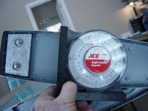

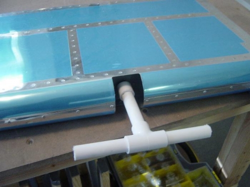

INstall rod ends into elevators and mount elevators to Horizontal stabilizer and drill control horns for linkage
Install rod ends, 1/2" pvc, cut a slot in the end of the pvc pipe and then put a coupling over it,

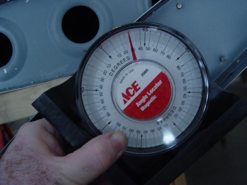

Check for 30 degree up travel - no problem!
check for 25 degree down travel -OK
