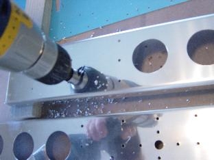

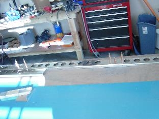

Elevator rear spar clecoed to skin and attach and final drill Hinge reinforcement plates

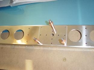

Cleco Hinge reinforcement plates to spars
Final Drill #30
Dril trim cable routing hole 5/8"
