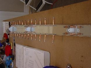

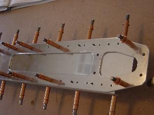

Brief Description:  Rear Spar Web and Caps
Steps 1,2&3 Fabricate VS1014 L&R, cleco to VS1003 - Made mistake, drilled for AN4 vs AN3, per Van's and RV10 list, Ok to continue and use AN4. Also Mistake, mach countersunk ALL spar doubler rivets instead of only below attach holes. Called Van's OK to use flush rivets and continue.

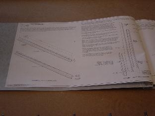

Sec 6 plans page
Sec 6 plans page
Rear Spar Doubler
Rear Spar Doubler
with Rudder attach brackets
