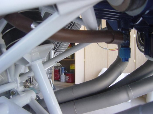

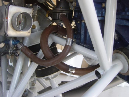

Atached the #10 Oil Line to connect the top and the bottom of the oil sump. I had to 'clock' the fittings a bit in order to get them to clear the engine/landing gear mount. All in all no big deal. The system was originally designed for acrobatics (inverted oil), and while I have no intention of flying upside down, I still need to connect the hoses to make the system complete.
#10 Oil line between top of sump and  bottom
