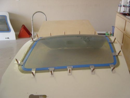

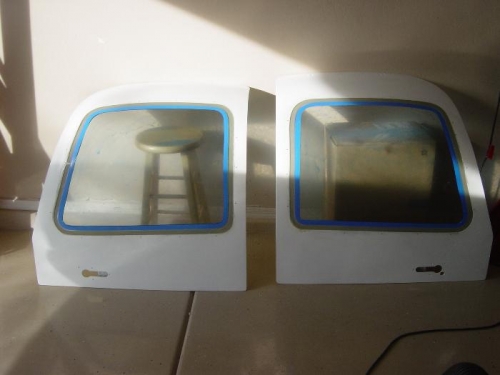

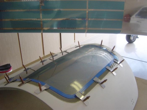

Finished up Epoxying/floxing in both door windows.They are turning out really great, and i'm indebted to Dave McNeil for passing along the detailed procedures for using epoxy/flox instead of the Weld-On, This has GOT TO BE a ton easier!!
The Windscreen remains, but I need to complete adding some access panels and painting the center cabin strut before proceding with it.
I also need to fill the holes I drilled for the cleco/fingers, and add a layer of fiberglass over the seam. But I'm going to wait and do all of this as a part of prepping the cabin for paint, as there will be a LOT of filling and sanding, etc.
Left door window floxed in place
Another view
Another view
Both door windows floxed in place
