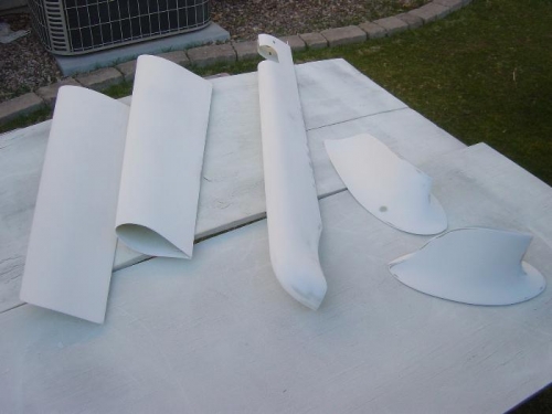

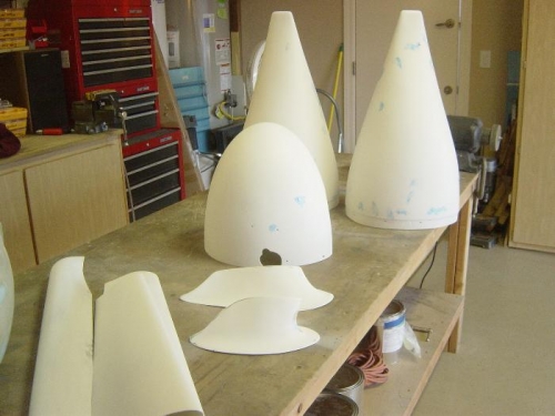

Went back and did some more time on the gear leg fairings. Got all of the leg fairings sanded w/ 22 grit, will shoot one more thin coat on them anbd then sand w/ 320. Filled the nose wheel fairing, The top of the nose wheel doesn't appear to be symetric and smooth, So I added a bunch of SuperFIl and will let that set up overnight and work on it tomorrow. Also got 2 of the intersection fairings thru 220 grit. Took the leftover SuperFil and filled all th epinholes I could see on the remaining parts.
Gear leg and 2 intersection ready for final coat Smooth Prime
Filled uneven spots on Nose wheel top
Pin hole filled remaining parts
