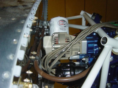

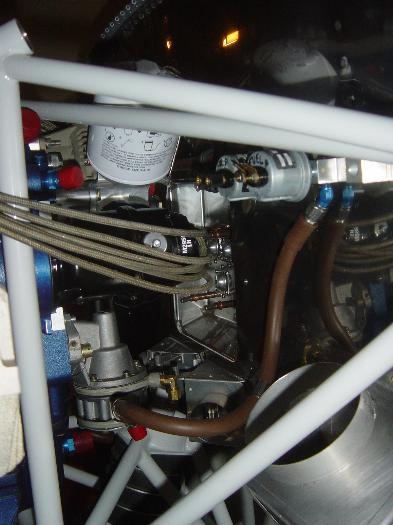

Began installing the fuel hoses. The Fuel fed from the boost pump to the engine driven pump line is in, the Fuel pressure sensor to the fuel pump lline is in. However there are # other fuel lines that I need. The VA 189 I ordered is too small for the AFP fm300, which sits much further forward because of the cold air system. Also the is a metered fuel line that runs between the #5 and #3 cylinders that connects the Fuel purge valve with the fuel controller, this is not stock. and Then there is a fuel purge return line that is also not stock I did some figuring on the lengthes required. i'll need to make some phone calls tomorrow and get 3 hew firesleeved hoses ordered.
Fuel pressure sensor hose
Fuel supply from tanks to engine driven fuel pump
Oil pressure hose
Oil pressure hose
