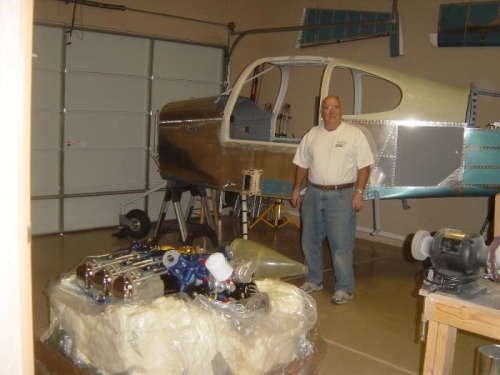

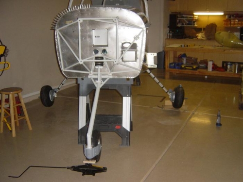

Didn't get all that much accomplished today. Mom an Dad called this AM and said they were on the way up for a visit, and while they were here the truck showed up with my engine. I couldn't wait so I had to partially unwrap it and snap a 'memory' shot. Re. the projet, was able to get the Fuse jacked up and leveled so as to begin to align the gear pants. made the spacer for the top of the wheel and got the Left wheel pant cut out to fit around the gear leg and brake line. This is the part that's definately easier to do with the wings off, as there is a LOT of up and down back and forth trying to get these things close to aligned.

Hopefully in a couple of weeks this will be attached to the front of the plane!
