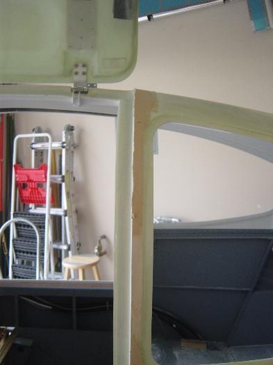

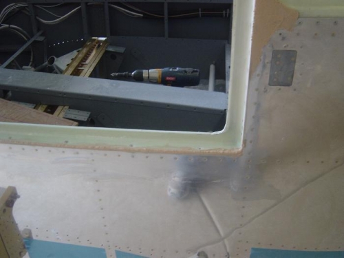

More of the same old routine, 1st finished installing the AN509-8 screws in the right door plate, the sanded off the filled spots from yesterday, identified a few more marked them with a sharpie, Mixed up more flox and troweled it into the gap between the cabin and the fuse, It will need an additional layer of micro spread over it to smooth it , but it's a good start. Then began to make the flox edge build-up around the bottom of the Left door and added another layer to the bottom of the right door.
Filled a few more low spots, I think this is the last of them
Began to build up the edge/gap on the bottom of the Left door
Flox mixture spread between the seam of the cabin cover and the fuse
