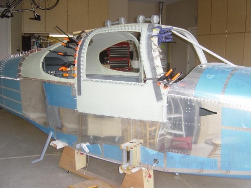

Manual Reference:  Sec 45-5
Brief Description:  Sec 45-5 steps 1-7 Right
With Judy's help wer tackled the Right door today. Much less stressful having gone through the Left yesterday. This went pretty much the same as the other. You shoud use caution when doing the initial triming of the door sheells as the cleco hole for the forward lower corner of the doors is right on the edge when you trim the corner. So either don't trim the corner, leave it square, or better yer leave a 1/4 -3/8" extra. You can see from th epic below that Ifixed a piece of angle alum and tied it to the upper hole in order to get an even pressure distributed on this corner.
Again Not very pretty .... yet
"Fix for having trimmed too much off of the lower corner"
