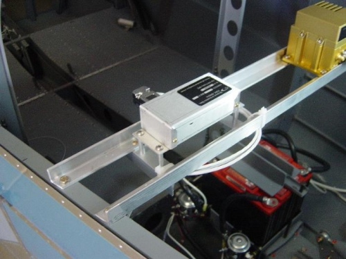

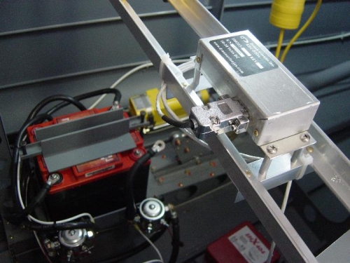

Mounted the Dynon remote magnetic sensor on the same platform as the Crossbow AHRS, and then ran the wires that came with the harness back to it from the forward fuse. Got everything connected by inserting the wires into the D-Sub connector, Mounted the sensor using stainless steel hardware, used some standoffs to get the connector high enough to clear the alum angles. Then ran the wire from the strobe panel switch to the strobe power supply. The dynon remote mag sensor will require some adjustments after the panel gets it's final mount as the sensor needs to sit at the same angle as the D10A, should be an easy thing to do by using some washers under the stand-offs.
Dynon D10A remote mag sensor mounted
D-sub connector facing forward
