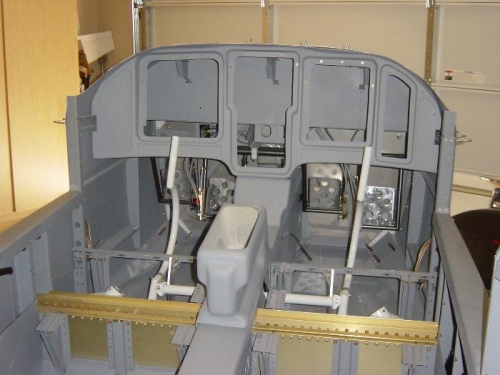

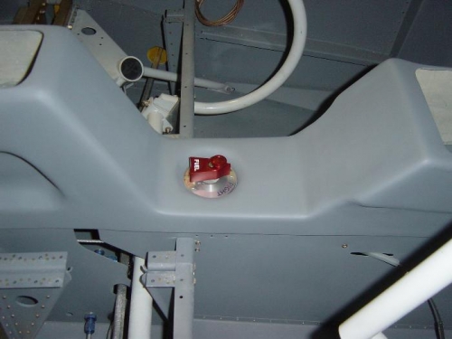

Finished filling and sanding (whew --- not fun!) the console. I primed it to see how smooth it turned out. It's' pretty straight. There are a few pinholes and a couple of spots that need more sanding, but I'll wait til Ican get some Featherfill or similar material. The stuff I've been using is a flexible polyester filler and it's a !@$#@! to sand, I primed the panel mounting plate and also the panel as well. Then remounted everything and took some pics. I still need to make the console /mapbox cover and mount it.
Console finished (almost)
fuel selector valve
fuel selector valve
