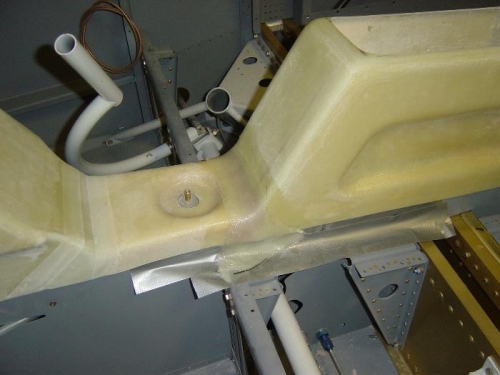

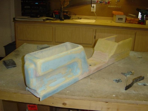

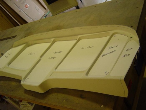

Relieved Console #3 so that it would fit flush with the other console assemly, then fiberglassed the armrest/mapbox to the other components. MAde some posterboard templated so that i can cut out the .0625 inserts that fit into the panel. Fortunately with the heat the console set up rather quickly and I was able to trim the glass and dress it. Removed the joined console from the fuse and the alum rib cap, and began the extremely boring process if filling, and sanding, filling and sanding,filling and sanding......... Started 1st w/ Bondo for the places needing to be built up, then switched to a sandable lightweight filler. The number of compound curves on this beast makes it difficult as everything has to be broken down into small steps which deal with a single surface at a time. Not finished with it, got the rear half done, need to continue tomorrow. Hope the finished product is worth the effort.
Fiberglassed the Armrest/mapbox to the rest of the console
Made posterboard templates to cut out the .0625 inserts
Finished the rear half (bondo and filler)
