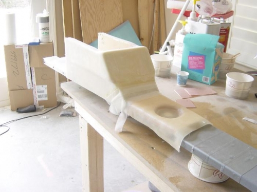

Brief Description:  Sec 41-2 console#2

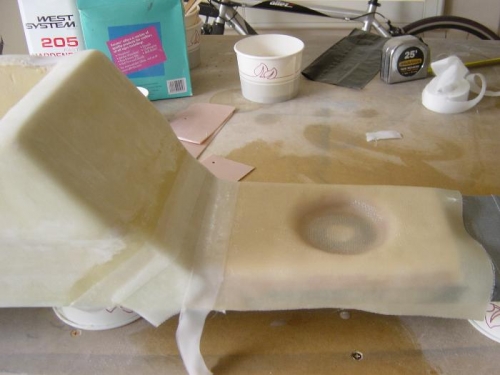

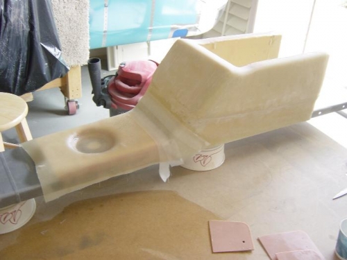

Sanded the #1 and #3 parts after the repairs. I decided that the finished console will be in 2 pieces console #1 and console #2 will be combined into a single piece, and then I'll butt them together with console #3. So I made the foam core for console #2 and glassed it to console #1. The last item to construct is the Armrest/glovebox cover and hinge assembly, then it's just fill and sand, fill and sand.....
Console #2 fuel valve cover
Joined/glassed to #1
other view
other view
