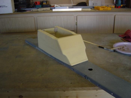

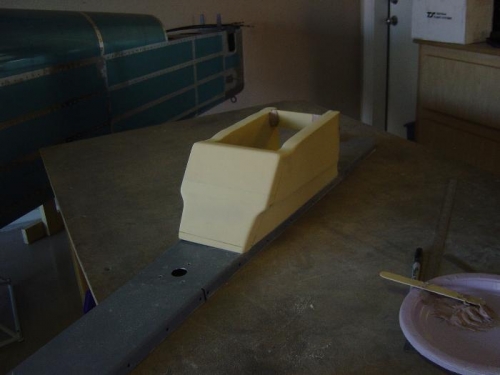

Finished shaping the 1st of 3 console pieces. This is the one that if the most fowd and fits directly under the panel and fwd of the fuel selector. Then Fiber glassed the foam mold/core. Initial lay-up was 4 plys, that cured (its 108 and cured FAST!) sanded that and then did another 4 ply lay-up. put peel ply on the edges & seams and I'll let it cure while we goe catch a movie tonight. I need to pick up some featherfill or some other fill/sanding agent. This is messy stuff, both the shaping and the fiberglass/sanding, looks like its going to be a messy week ahead.
temporarilly bondo'd to the rib cover while shaping
