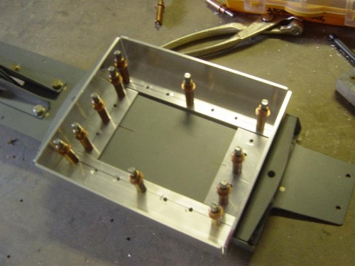

Finished off the Battery holder tray and installed the Tru Trak pitch servo mounting bracket. Reinstalled the Elevator bellcrank and the battery tray to the Tailcone ribs. connected the elevator pushrod to the bellcrank. Didn't have to adjust the control stick pushrod lengths as they were sopt on following the dimensions in the plans, and are perfectly parallel.
Battery box angles drilled prior to csk and riveting.

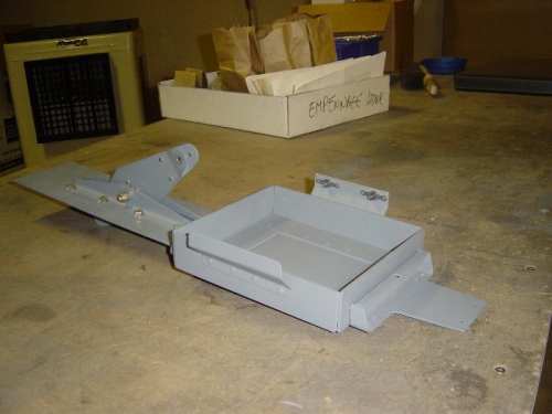

Assembly complete, reused one contactor support and fadeb an additional one

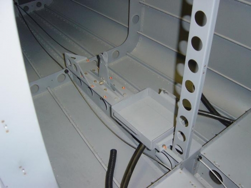

Reinstalled in the ribs w/ Control pushrod connected.
