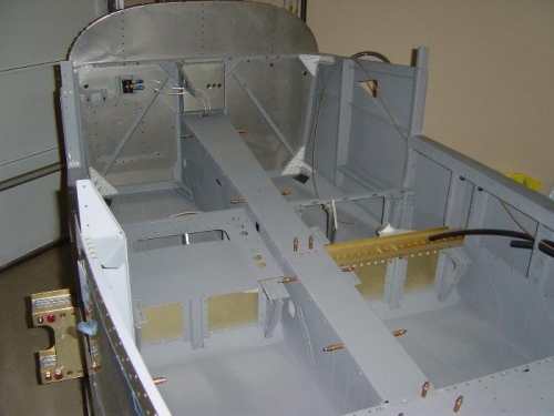

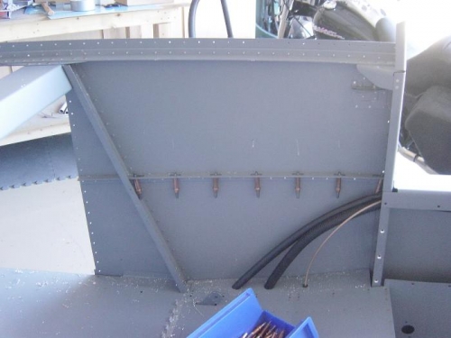

Continued with the access covers and panels. It's hot as !@#$ today, (104) tough to spend too much time in the garage. This took longer than I expected. installing the nutplates that hold the top of the rear seat side panels was a booger. The problem is in trying to get the rivets set. I don't have a manual squeezer, that may have helped. But had a tough time getting the pneumatic close enough to the fuse sides to make a good squeeze. I also subsituted MS 51??? for the two end nutplates as there was absolutely no way to get the std nutplates squoose. I tried bucking them and that didn't work, Tried using the vice grips and that didn't work, ended up with the pneu, but it left the manf heads sticking up a little, so I took the vixen file to make everything flush. Also the MS511!@$#!@ -08's in the forward hole, I ended up drilling them out for #30 and put in CS4-4.s to hold those.
Nutplaltes clecoed prior to drilling
Nutplates installed --- Finally!
Everything (almost) in, just clecoed as it all has to come out for systems installation.
