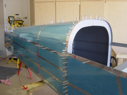

Countinued with the tailcone attach. It's the same drill again cleco everything together match drill, dissassemble, deburr, and then dimple. th eplans are pretty detailed and it goes fairly fast. Tomorrow I should be able to get it riveted depending on bucking help (or lack of).
Joined and match drilled

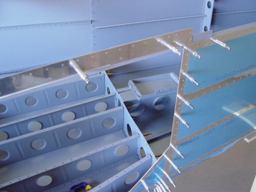

I had the F1006 bulkhead installed backwards @ 1st, made it a little confusing until I recognized it
Tailcone top skin match drilled to the F1006 bulkhead
