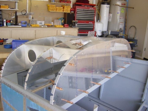

Manual Reference:  Sec 31-6 and 31-7
Brief Description:  Sec 31-6 and Sec 31-7 All steps
Fabricated the instrument panel and attached the entire assembly to the Fuse, Match drilled everything, including the hand hold doublers. I don't intent to use this instrument panel, but rather a fiberglass one with a little more horizontal room, but the sub-structure is the same, and this provides significant stability during the interim.
initial assembly clecoed to Fuse
Instrument panel added
Top skin clecoed and everything match drilled.
