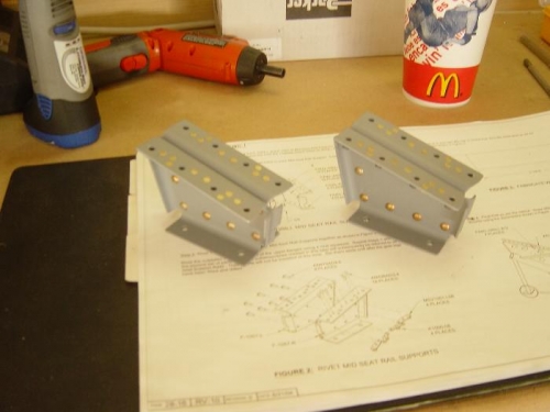

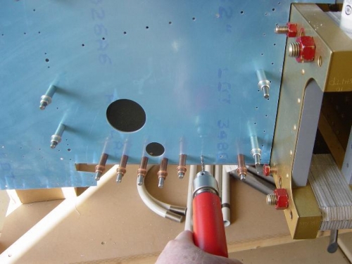

Finished off Chapter 28. Made the seat rail supports, well one set of them, I miss marked one of the parts and cut it wrong for the other pair, another misc order to Van's. The Gear mounts are a tight fit, and I finally figured that they were binding on the opening in the bottom skin, It took a bit of back and forth sanding/filing/gringing with the dremel on the oval openings to get enough clearance so that the AN3 bolt holes would align properly. the problem is that there is a weld bead on the bottom of the gear mount and the bead interferres with the opening hole so you have to enlarge the opening. I saw where one builder had a problem with his gear mount not being correctly made and I worried that I might have the same problem, but it turned out OK.(04/05/05) Received the replacement part from Van's and finished off the Mis seat rail supports

Match drilling using the fwd skin as a drill guide
Mid Seat Rail supports finished
